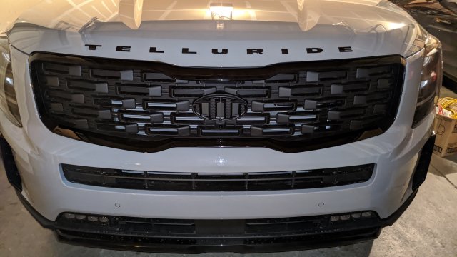

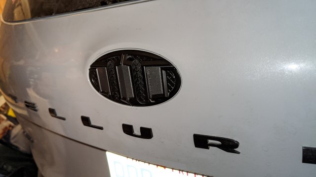

Ok so, the Nightfall Edition's front badge did not sit in a removable clip, it's clipped directly to the black grill itself. Quite a pain to remove. The rear badge is affixed exactly the same though, just adhesive and the two pins
Got it off eventually and replaced front & back with the Gen3 Black Brenthon badges. Pretty pleased with the look, the wolf grey really does go well.
