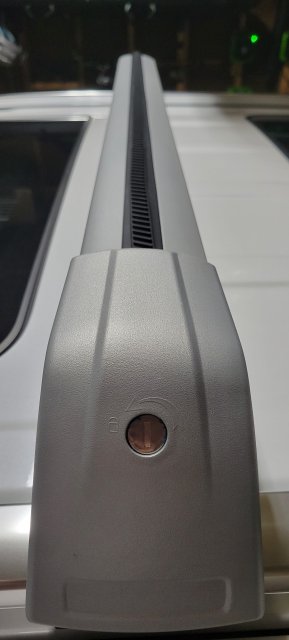

Old thread, but we just bought a CPO 2020 SX Prestige and a family member bought me some silver cross bars off Amazon to better match the chrome/white roofline of our Telly. But the chatter they made at 40-50mph was horrendous. Glad I came across this thread! I adjusted my bars to the dimensions Kia recommends on the OEM bars (thanks for posting those btw!) and I also found and installed these NXTGEN AeroGrips, available on Amazon and Etsy. If anyone's still struggling with wind noise or whistling, give these a try! It makes the airflow turbulent across your bars, preventing laminar airflow over the bar, which is what causes the whistling.
