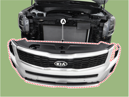

Anyone have any idea where the horn is? And how to get to it? I have a single train horn that I took off my FJ Cruiser and want to put it on the Telluride but have to find the OEM horn first...and then have to figure out how to get behind the grill and in front of the radiator (i'm guessing the horn is in that area) to mount it.

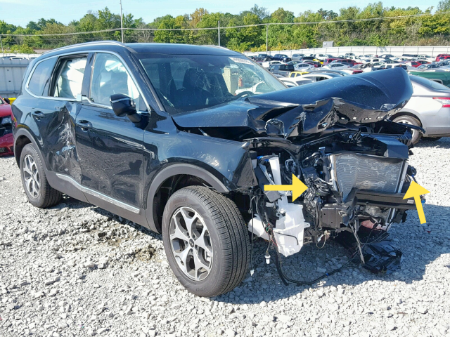

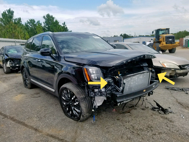

Umm...I hope I don't have to remove the bumper in that manner??? :( Dare I ask what happened to the other vehicles? Still trying to figure out how to remove it. But thanks for posting where they are...sure don't sound like 2 horns.

I'm not sure what happened to those vehicles, I found the photos on copart.com which I'm always on there browsing for deals.

Well, it certainly looks like a rather drastic way to remove the front end. It looks like the radiator cover and complete front end are all one piece. What a pain to get in to!. And I think if I remove the skid plate, the horns will be too high to reach from underneath.
49
The grill does detach from the bumper but you have to remove the bumper to be able to detach it lol.

Sounds like the Sorento, The whole bumper,grill,and radiator cover was all one piece that got removed together.

Did anyone ever crack the code on this? I want to install a train horn, but donā€™t want a secondary switch.

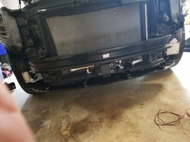

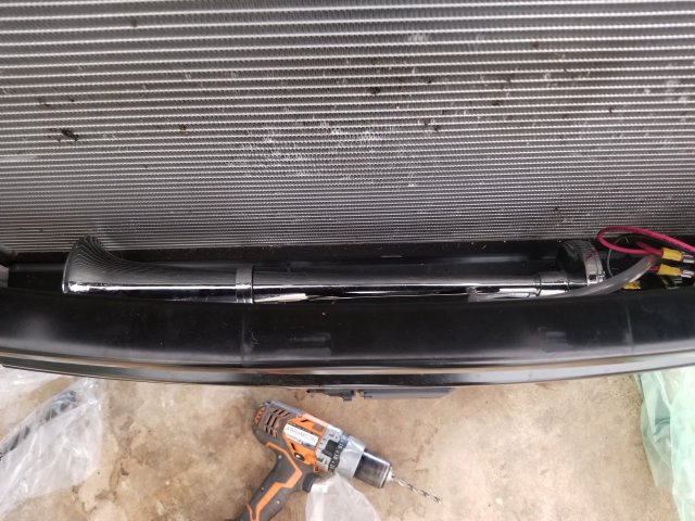

I already knew where it was but getting to it was the issue. The horns are mounted on either side of the radiator and the only way to get to the wires (unless you have super tiny hands and can reach in) is to remove the front bumper/grill. Not super difficult but a pain in the a**. I attached my single train horn (there's not really room for more than that) to the tray in front/under the radiator and if you were to look carefully, you can see it through one of the front air vents. 20200807_114133.jpg 20200807_070610.jpg

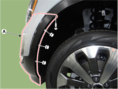

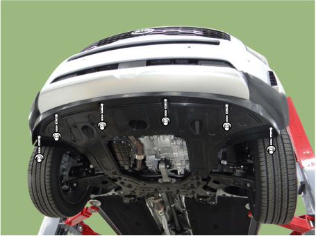

I didn't take any videos. Was to busy installing the horn and brush guard. You pop the pins at the radiator cover, 3 in the wheel wells plus 1 screw and about 8 bolts under the front end of the car. Then grab the bumper at the wheel well and start pulling...there is one clip around the bottom of the headlight that you have to pull hard to release. All the diagrams are in the service manual.

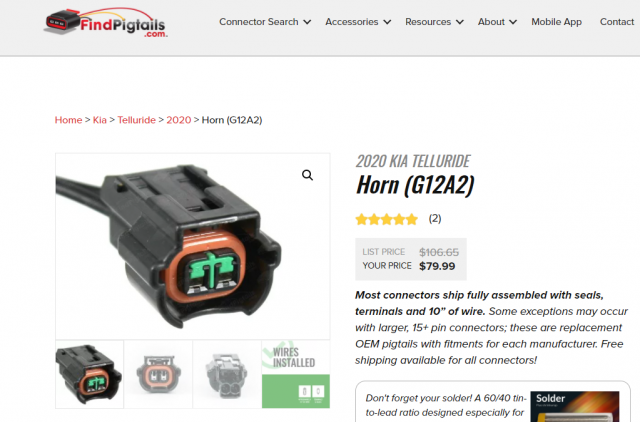

This is really helpful, thank you! Did you add you train horn to the OEM ones, or replaced them? I'm trying to figure out what to do, and I can't even find info on what type of connectors the OEM have. Ideally I would need to remove the aftermarket horn (considering either a Stebel Nautilus or a Wolo 419 Bad Boy) before returning my lease, so I prefer not to splice cables so it'll be easy to reconnect the OEM. I saw this site which made me wonder if the Telluride uses a special connectors for its horns:
Do I need to get such an adapter? I would really appreciate your help with the wiring configuration. Thanks!
