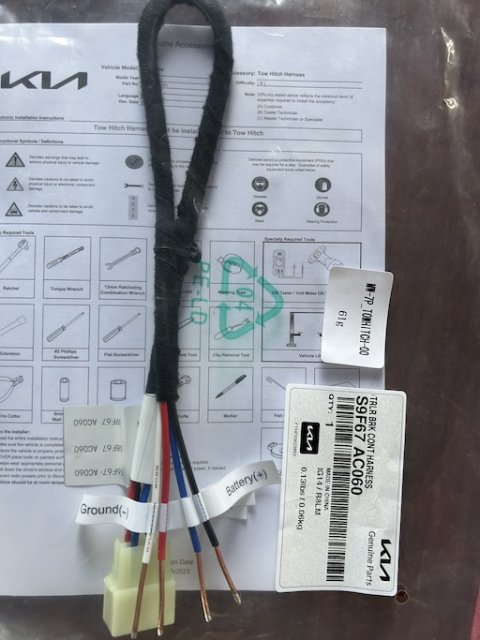

My 24 X-Pro came with the tow hitch installed, but for some reason the brake control wiring is not installed; it was in a zip loc bag in the rear storage compartment. The bag says it is part number S9F67 AC060. The bag also contained a booklet for the Tow Hitch Harness installation and at the end of the instructions it said, "Install the Electric Brake Module per instructions provided with the Electric Brake Module." Of course there were no instructions provided for installing that part. IMG_0326.JPG

Same thing here on a 2024 Telly. Other threads "suggest" that this is for when you tow a trailer with electric brakes. But looking for a definitive answer. Emails to the sales person who sold it to us have been unanswered. Anyone out there have definite info on this part and why they include it the way they do?
Kmiles
Puget Sound WA
I had the same question and found the answer. You buy whatever brake controller works best for your needs and this harness connects to the brake controller with the 4 bare wires and the harness plugs in under the left hand side of the dash. Many people mount their brake controller to the fuse box cover. There are also bluetooth modules that don't need a mounted controller. You still need to connect those controllers to this same harness and the hide it up under the dash. Check out eTrailer for a selection of controllers that work with the Telluride.
