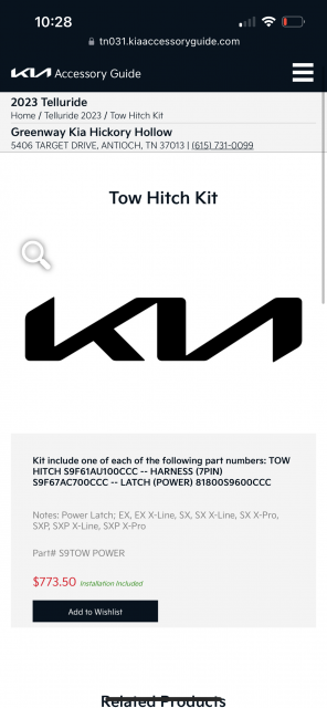

This is a how you get a dealer quote for the hitch, wiring harness, and rear latch. The latch is for the power lift gate trims of the EX trim and up. The LX and S will not have the latch. (i’m assuming) I also looked this up on my iPhone, so the layout may be different on another device.
1. Go to https://www.kiaaccessoryguide.com
2. Go to the 3 bars in the upper right hand corner.
3. Select Search.
4. Put this part number in Part# S9TOW.
5. Hit Search.
6. Scroll down and select whichever trim you have for the correct hitch.
7. Click ADD + to add it to your wish list.
8. Click get price.
9. Enter your zip to find a dealer.
10. Select you dealer. You may have to scroll through the different accessories to get back to the hitch. I don’t know why it’s not the first thing to pop up.
11. Click view accessory to see the price which includes installation.
You can then email yourself and your dealer, if you want, this price and part number. The price will include installation, but I’m assuming tax will have to be added. All three parts and labor are under $800 in my area of TN.
