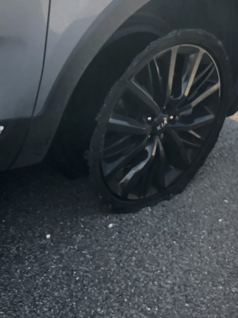

On the highway last weekend my tire blew out. There was no damage to the car or any injury but my tire is done for. Does anyone know if a full sized spare will fit in place of the original spare tire? The KIA dealer says tire warranty issues are handled by the tire manufacturer and Michelin says to take it to an authorized dealer to have them check it our. We didn't hit anything on the road so I think its a faulty tire.

Glad you and the family are all right. A full size tire won't fit underneath. If you take a look down there, the temporary spare squeezes in there pretty tight.
Were you carrying a full vehicle?

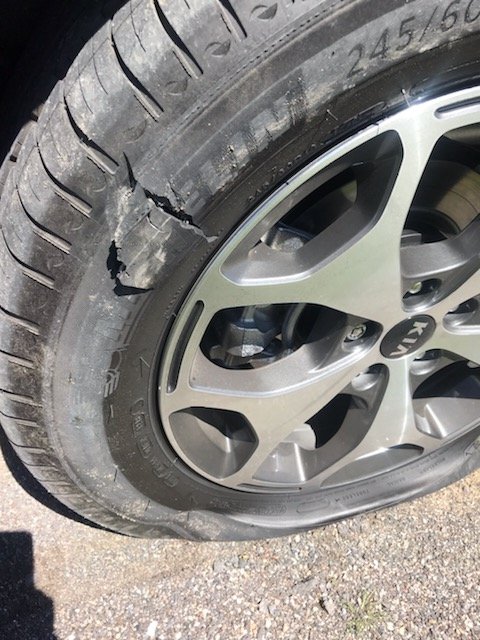

Looks like road debris cut. It sliced into the top and cut down the sidewall.
Yea, it does look like that, but will be interesting to see what Michelin says. You'll have a tough time getting them to agree to a tire defect. On my old BMW 750 with 20" rims and run flat tires, I developed bubbles on 2 tires on the side walls. Both BMW and the tire manufacture (I think it was Goodyear) said they were damaged because I hit something (I.e. pot hole, etc) even though the rim had no damage (these were very low profile tires). Good luck and hopefully you'll get some reimbursement!

I agree it does look like there's a slice right above the "H". Still keep us updated on what Michelin says.

The nice people at Costco convinced me that the blowout was due to a road hazard. After the tire was off and we looked closer it does seem like we ran over something that sliced up the side of the tire from the tread and then pushed though the sidewall. Whatever it was had to be small because we did not see anything in the road to avoid and nothing laying around after the fact. I ended up getting 4 new tires because everyone around is out of stock for the OEM tire. Ill order a new one and let it sit until the new set wears out.

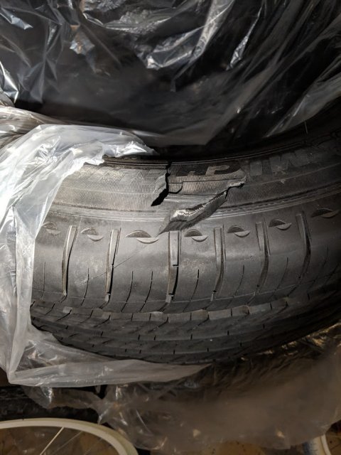

I have a 2020 Kia Telluride. I already replaced one tire for a bubble in sidewall.
I had approx 2 months of my car pulling slightly to the right and after having an alignment last week that didn’t fix the issue.
Yesterday, my car started making a noise that sounded like a flat tire. I got out of my car walked around it looking at all the tires, all looked normal. Minutes later the tire light came on, and as I tried to drive to a safe location I had a complete blowout (on the freeway without a shoulder).
The rim is intact all the way around with 2inches of tire left around the edge. This appears to be a manufacturer defect that could have caused a major accident.
I hope this post gets to the attention of Kia and the tire manufacturer….
