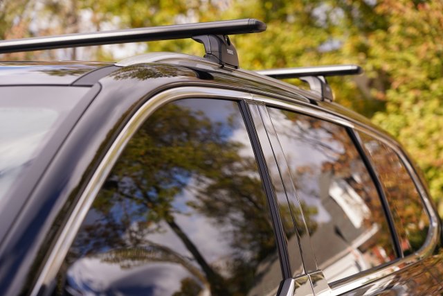

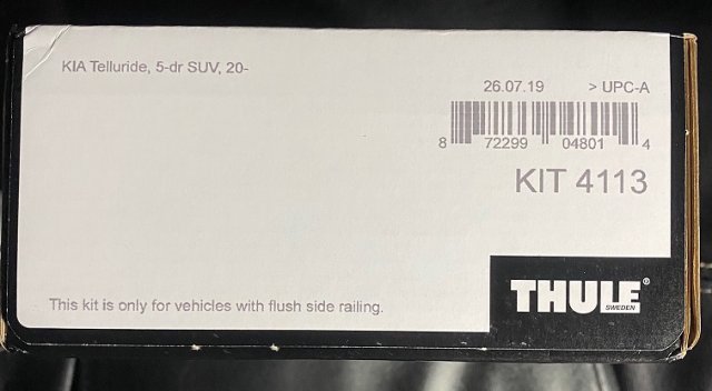

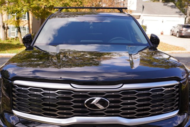

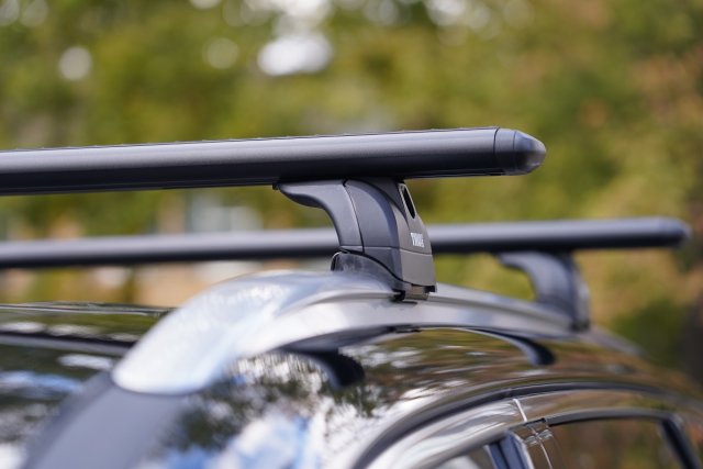

Here are the fully installed pictures. The rear bar looks a little further up, but it is spaced so that a Yakima SkyBox 18 cargo case will clear the hatch when mounted on the cross bar.

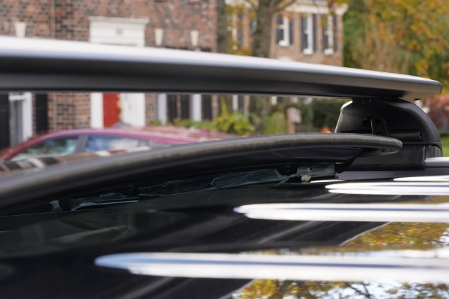

Lastly, here is the clearance between the Sunroof and the Bar. It's between 1"-2" clearance.

Comparing retail to retail price, the Thule is not that much more expensive. The only piece you'll have to pay retail for the Thule would be the Fit Kit. The bars and feet can be found discounted.
Also, according to the Telluride owners manual (4-172), the roof rack can support up to 220 lbs max (evenly distributed). The WingBar Evo 150 is also rated for a maximum load of 220 lbs (evenly distributed) on their website. https://www.thule.com/en-us/roof-ra...nd-accessories/thule-wingbar-evo-150-_-711520
