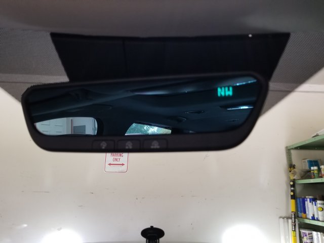

I bought the Homelink mirror for my EX and swapped them out. I plugged in the new one but the compass just shows a "C". I thought it was plug and play? Am I missing something?
My guess is, "C" means calibration required. (usually involves driving around in circles or something like that). No instructions with it?

I purchased a Homelink mirror to put in my EX and it was very simple. Remove the plastic shield behind the mirror, unscrew the torx screw holding the mirror in place. Remove the wiring harness plug and plug it in to the new mirror. Mount the new mirror using the torx screw and replaced the plastic shield. If yours is like mine, the compass will show a "C" for Calibration mode. Drive it around in circles a few times and it should calibrate. To use the garage door buttons, I found this video that explains everything...
