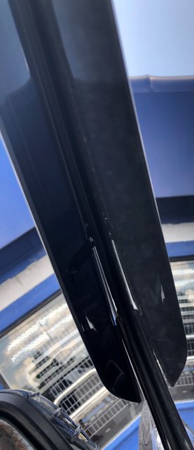

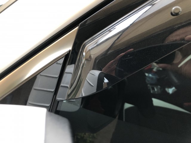

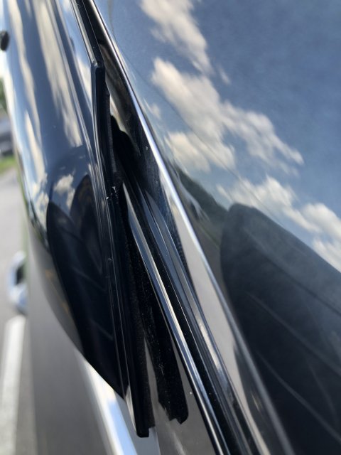

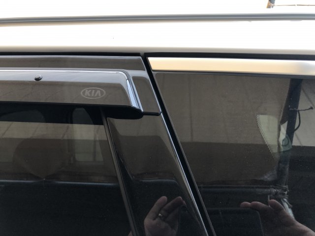

The front door guard, where it buts against the trim, did it go over the trim perfectly or does it go on the window. Mine dont fit right over that black triangle trim near the mirror, the guard has no stickey tape just foam on that 2inch downward part. I think it goes against the window....????? is that what i see in your pic?

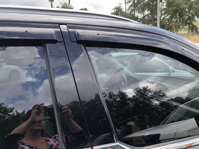

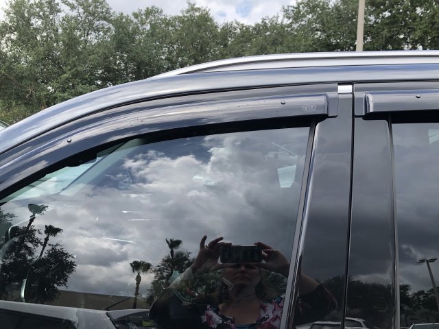

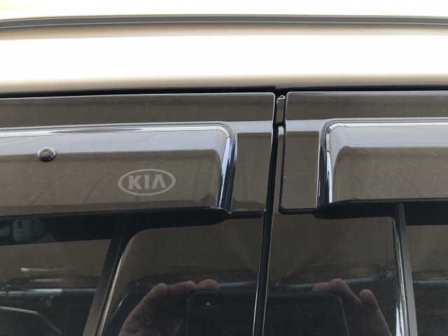

YES you right, the front end wont glue on the surface the foam goes right on the edge and just be careful with the rear ones make sure you place them all the way to the back and in the mid section you will have a gap but if you don't left that gap the front door will be scrapping que rear visor Also to blur the gap between visor on the mid section I cover the silver trim with a piece of black vinyl Will post a pic later today (closer)
