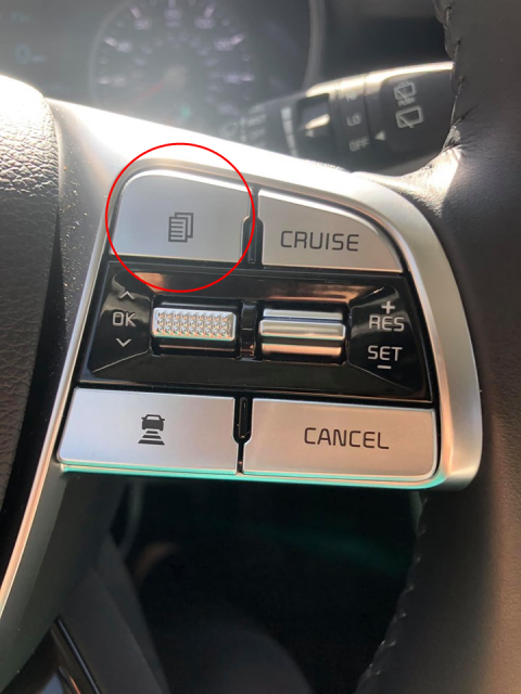

Would you know this as well?
My dealer change my settings for the crash warning and made it way too close. Is there a way to change the distance from another car for warning. Thank you. I have the SXP.
On your steering wheel press the MODE button until you see User Settings. Then select Driver Assistance > Warning Timing. You can then adjust the settings in there.
