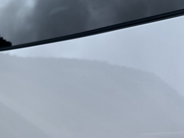

I can’t say why it’s there exactly. We don’t drive on any tar/chip roads or new pavement in the last two weeks. Haven’t ran our sprinklers. It’s on the hood doors and tailgate.

That sounds like some sort of road spray, especially because of the fact that you also got it on the tailgate. Can you remove the speck? Is it dried on? Perhaps a contractor truck you were following was dripping paint or leaking oil?

Hey all, if this is your first light colored vehicle, what you're seeing there is called "Environmental Fallout" or "Rail Dust" and you'll think your car is rusting, it can get pretty bad, but it's no fault in the paint, it's just like iron filings landing on your paint and rusting above the clear. Iron removal sprays work great even if they are just another thing you need to do to take care of it!

It is rail dust form the transport small parts of oxidized metal get stuck in the clear coat and start to rust if you take workhorse or a strong solvent and rub gently it will come off. I sold a ton of Tellurides last year and we had to overcome this a few times.
