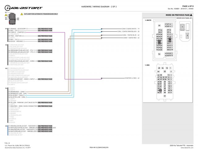

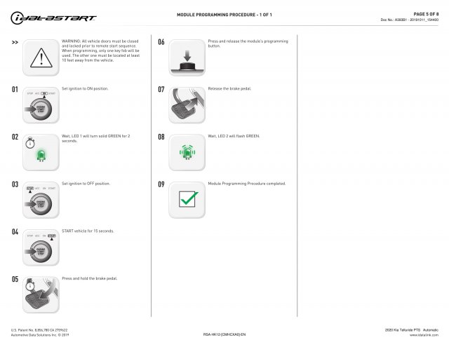

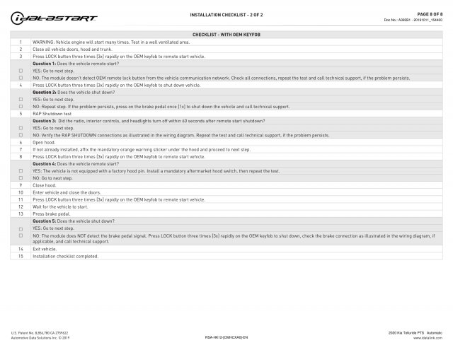

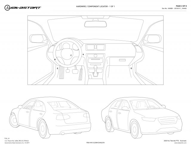

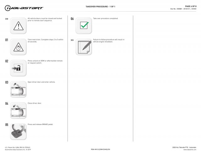

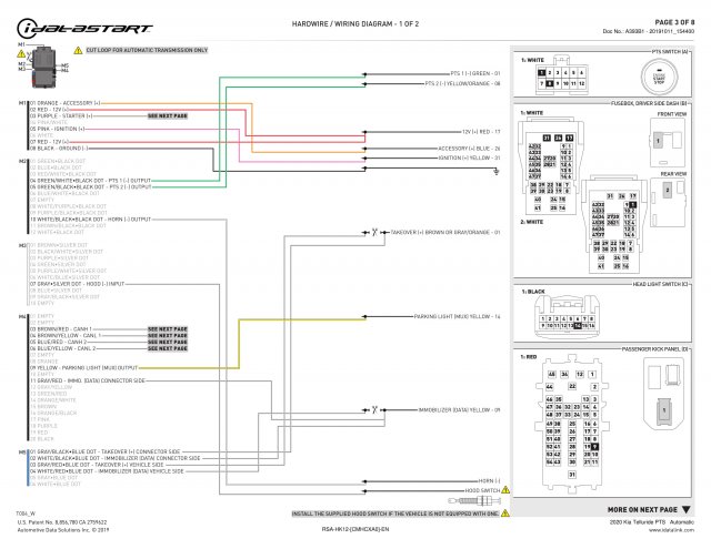

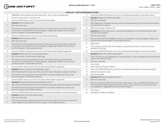

#33
Ok, so you need the RSA-HK12. Is that all or is this an additional device for use with the HCX000A. I have seen the HCX000A on Amazon, but no mention of RSA-HK12.
Has anyone here installed one of these on a Telluride?
I think most owners are still using the app for remote start.
For the idatastart HCX000A (Includes CMHCXA0 control module and ADS-AHR-HCX analog harness kit) hardware is needed with RSA-HK12 being the firmware. See the install guide below.
https://www.idatalink.com/product/product/product_id/360
RSA-HK12-[CMHCXA0]-(Kia_Telluride_2020_29627)-EN_20191011_154400-1.jpg RSA-HK12-[CMHCXA0]-(Kia_Telluride_2020_29627)-EN_20191011_154400-2.jpg RSA-HK12-[CMHCXA0]-(Kia_Telluride_2020_29627)-EN_20191011_154400-3.jpg RSA-HK12-[CMHCXA0]-(Kia_Telluride_2020_29627)-EN_20191011_154400-4.jpg RSA-HK12-[CMHCXA0]-(Kia_Telluride_2020_29627)-EN_20191011_154400-5.jpg RSA-HK12-[CMHCXA0]-(Kia_Telluride_2020_29627)-EN_20191011_154400-6.jpg RSA-HK12-[CMHCXA0]-(Kia_Telluride_2020_29627)-EN_20191011_154400-7.jpg RSA-HK12-[CMHCXA0]-(Kia_Telluride_2020_29627)-EN_20191011_154400-8.jpg
