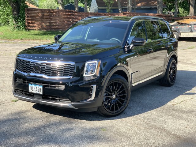

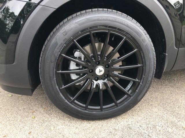

It's crazy how switching out the wheels/tires makes the Telluride look like a completely different vehicle. I returned from an out of town trip this afternoon and as my Uber pulled up to my house, I saw my EX sitting there and it struck me how different it looks now. Man, I sure was NOT a fan of those stock EX wheels.
515EX
19
Des Moines, IA, USA
I couldn’t agree more! Everyone at the shop I got my wheels from was saying the same thing. Night and day! I’m thinking about powder coating the stock wheels for when I use them during the winter. Would like to keep that all black look all year around.

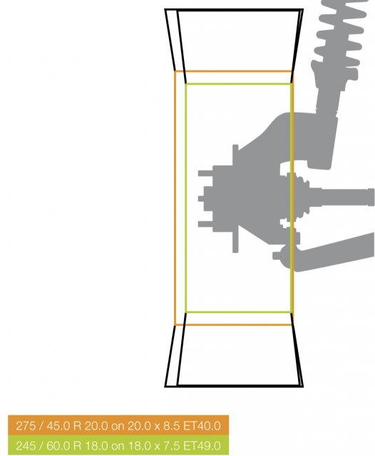

black EX wanting new wheels! What is the widest wheel and tire setup anyone has went with? Wanting to go with 20's and the widest tire that will fit without rubbing.

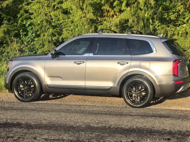

I have 275 on mine. No rubbing. But performance and fit involve other variables like offset and scrub radius as well.
31
24
what size wheel are you running? offset? Any pics of your telluride
275/45R20 on 8.5 with an offset of 40 and a 8mm positive scrub radius. This moved the tires 24mm to the outside compared to stock config on my EX and the wheels 22mm out. Also moved the tires 6mm closer to suspension and the wheels 4mm closer. The new set up filled out the wheelwell an additional 2mm.
Here's a helpful tool: https://www.wheel-size.com/calc/?wh...-20X8.5ET40&wcl=32mm&fcl=50mm&scl=50mm&sr=0mm
