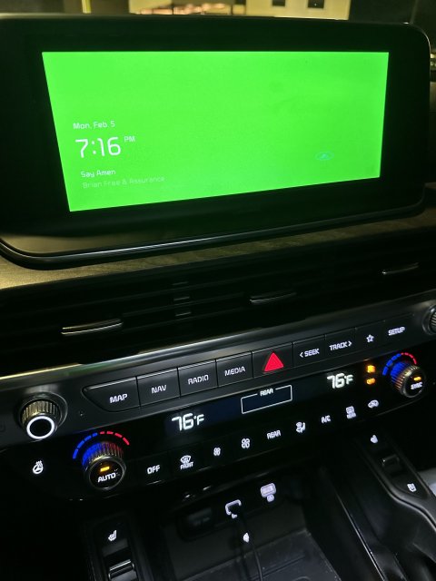

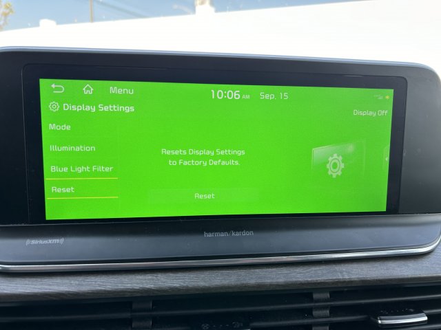

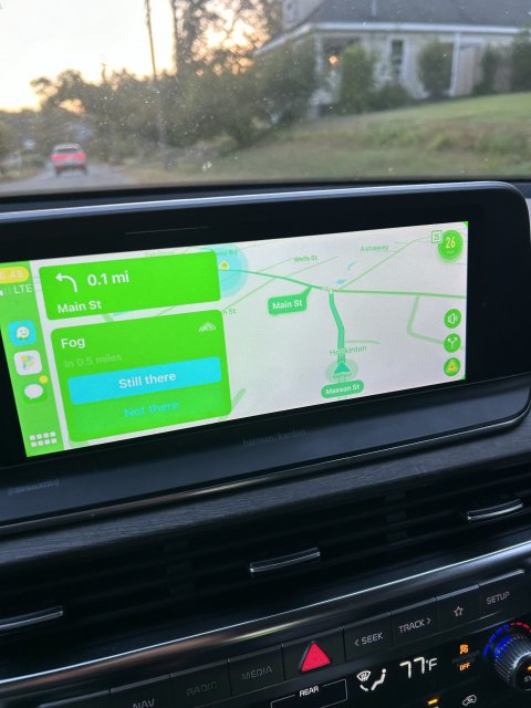

I have a 2020 Telluride EX and have recently started experiencing issues with the infotainment display turning green. At times it will stay green all day and suddenly flip back to normal and other times it will flip back and forth intermittently. It is almost like a short in a wire but no road condition (rough or smooth), turning sheltering wheel to either side, or any other circumstance seem to have any effect on it switching between green and regular screens. I have tried resetting the system but that also doesn’t have any effect. It is very random. The system has also been updated with the latest software updates.
