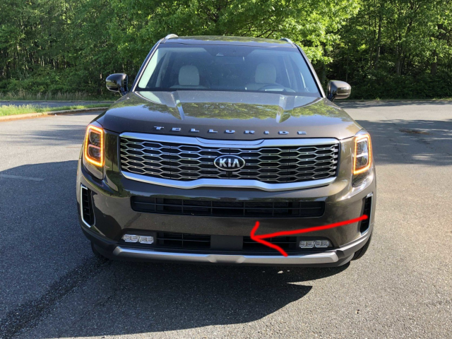

Windshield has nothing to do with those sensors....
80
29

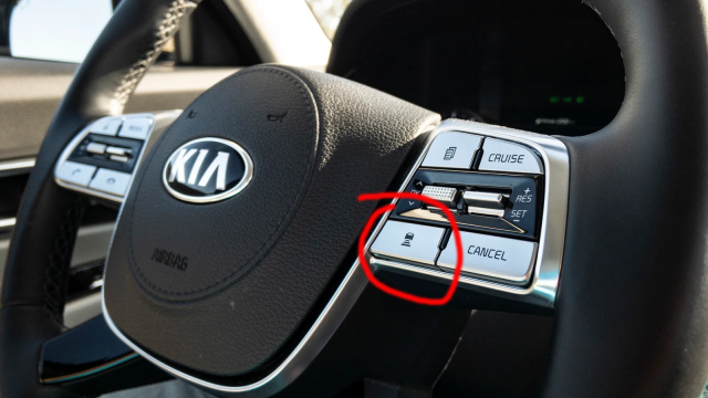

The sensors for the smart cruise control is in the lower front grill. There are no sensors attached to the windshield. You can adjust the distance from the steering wheel button.

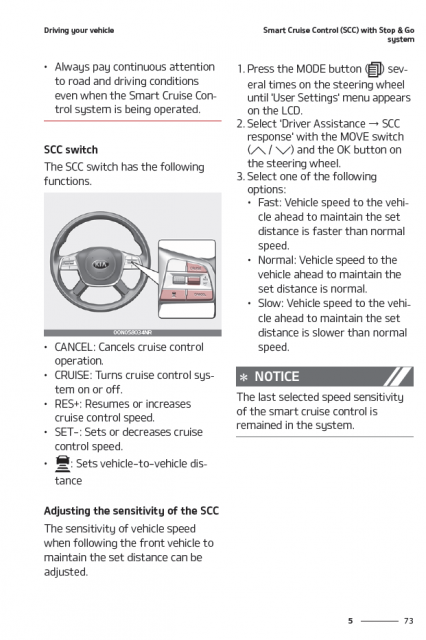

In case you need it from page 5-73 in the Owner's Manual.
  • Press the MODE button several times on the steering wheel until 'User Settings' menu appears on the LCD.
  • Fast: Vehicle speed to the vehicle ahead to maintain the set distance is faster than normal speed.
  • Normal: Vehicle speed to the vehicle ahead to maintain the set distance is normal.
  • Slow: Vehicle speed to the vehicle ahead to maintain the set distance is slower than normal speed.
