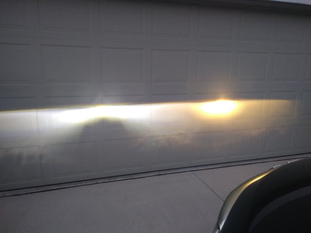

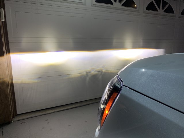

These are almost twice the brightness of the original led bulbs from twelvolt and are brighter than the m2 bulbs. These bulbs are also 1/3 the price...
Just drove around in almost pure darkness and the lighting is great. No dark spots and the distance is pretty good.
https://www.amazon.com/dp/B07N4K1L7G/ref=cm_sw_r_cp_api_i_JjrZCb5F6ZZFH
Now compare beam pattern to stock like I did. You see that large dark spot on the bottom of the beam? Do you have some night shots of the new build you tried. When I had my last set I had a beam pattern just like yours and had some dark spots in front of my car.
Not Active
335
#78
Like I said. I drove around and didn't have any dark spots. Up close you'll always have a weird looking pattern with these led bulbs.
I tested 5 different bulbs in the past week and all had a weird pattern. Some had dark spots and some didn't. These came out the best. I'll try to take a night shot layer tonight. I already tossed my crappy stock bulbs lol.
