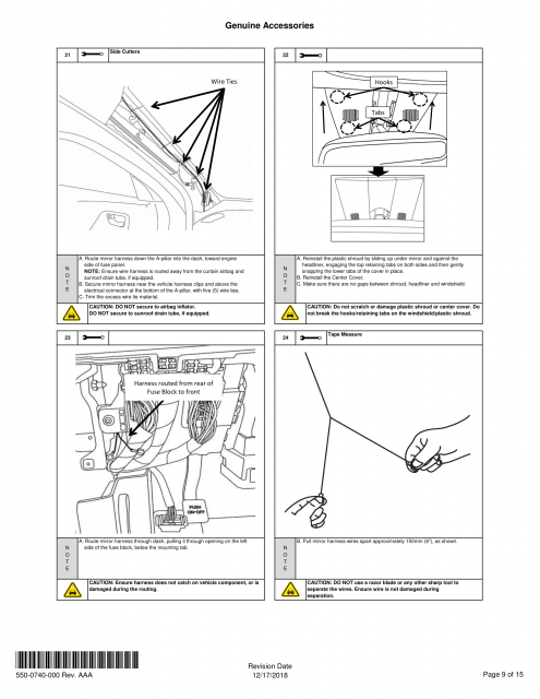

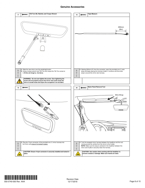

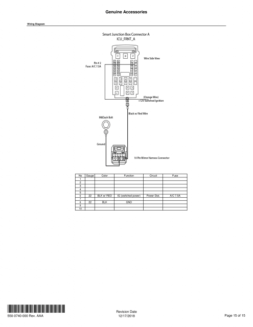

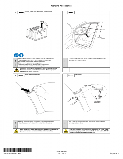

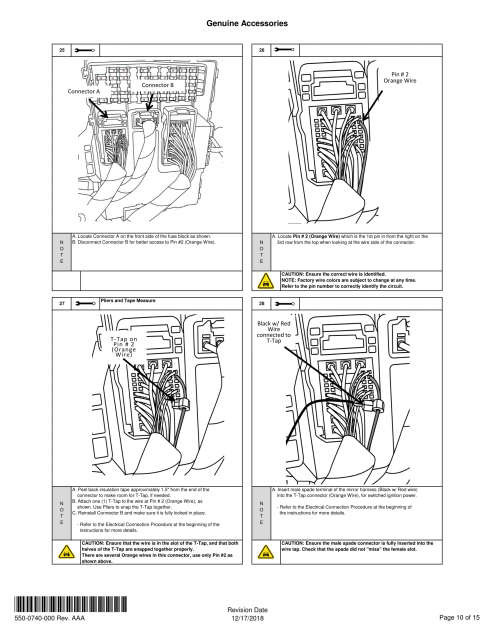

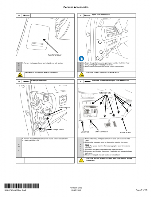

The safest way would be to run power from the fusebox. You can follow the same instruction for the mirror installation.
telluride mirror instructions-01.png telluride mirror instructions-02.png telluride mirror instructions-03.png telluride mirror instructions-04.png telluride mirror instructions-05.png telluride mirror instructions-06.png telluride mirror instructions-07.png telluride mirror instructions-08.png telluride mirror instructions-09.png telluride mirror instructions-10.png telluride mirror instructions-11.png telluride mirror instructions-12.png telluride mirror instructions-13.png telluride mirror instructions-14.png telluride mirror instructions-15.png
