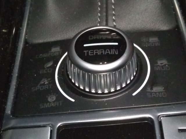

What about for sand/mud mode?
Also are there changes to throttle response and shift points?
Knowing these details would be wonderful but I'm guessing it's proprietary info as I can't find any official details.
Never heard of sand and mud mode. Can you post pictures of the mode selector? There is 4 wheel lock that will deliver even power to all four wheels under 25mph.
