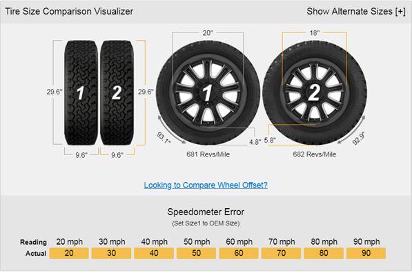

Is anyone else having an issue with snow (frozen slush) accumulating in the wheel wells and wheels and causing a shake/shimmy at highway speeds? We have had a lot of snow lately and this happens every storm. Perhaps it is only an issue with the 20" wheels? There isn't mush space around them which makes the frozen stuff hard to clear out of there. Best bet is probably to hit a car wash and spray it out of there. It is a little annoying. I am more used to driving trucks so haven't experienced this issue before.
103
62
Woodstock, IL, USA
Overall size of the 20" wheels/tires is within a fraction of the overall size of the 18" wheels/tires
