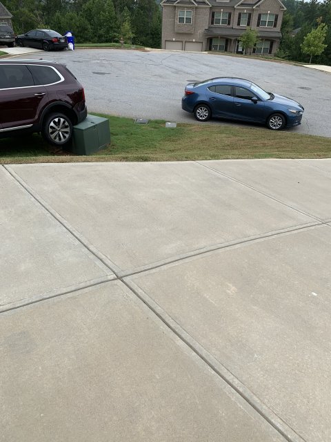

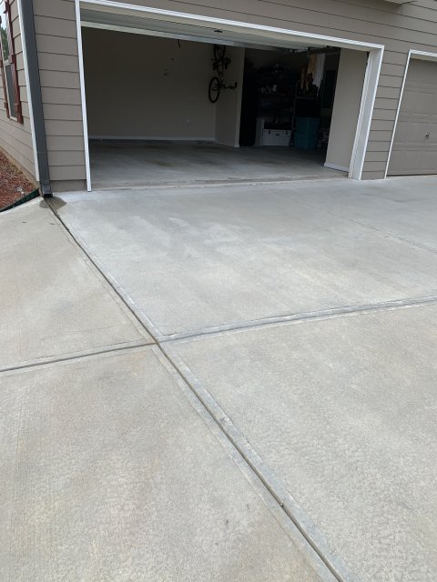

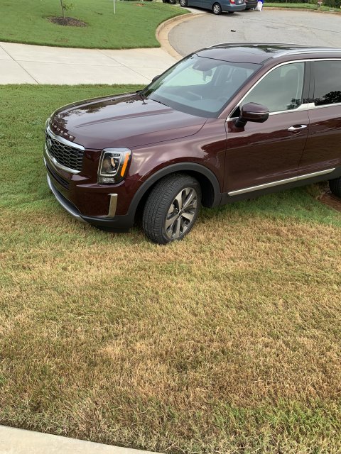

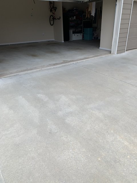

Saturday morning I started my car, forgot I left my charger and went back in the house. My lawn guy starts to scream thinking I was in the car and I come out to find my car has reversed onto an electric transformer. I know it sounds crazy but I had to walk behind the car to go back into the house. So the car was not moving. I hear this was a problem back in 2011. I am not comfortable with this car now

Sounds like you spaced and left it in reverse when you got out, we've all been there. If you are saying the car on its own, shifted out of park into reverse, that's a real stretch.....
James I have no problem admitting when I have made a mistake but I need answers. Why wasn’t the car moving when I walked behind it to go back in the house? Why did my lawn guy witness a vehicle going too fast to just be drifting? Why did the dash say Park but the gearshift was in drive when my lawn guy looked in the vehicle?

You're asking questions only a technician or kia engineer can answer. If you haven't already (which I assume you already did), take it to the dealer to have them evaluate and analyze the computers.
Little Rock, AR
I can only assume it didn't move when you got out and walked behind due to the safety features in the sensors which auto brakes when detecting an obstacle. Who knows.

I'm interested in what the KIA techs have to say but my junior detective ring tells me that there was a malfunction on the dash display making you think the vehicle was in park while the vehicle itself was in gear. Though I'm confused how it drifted backwards with the shift in "D"rive. I'm asuming you parked front side into your garage. I'm also wondering if the car's electronics override the gear shift if it detects a hit.

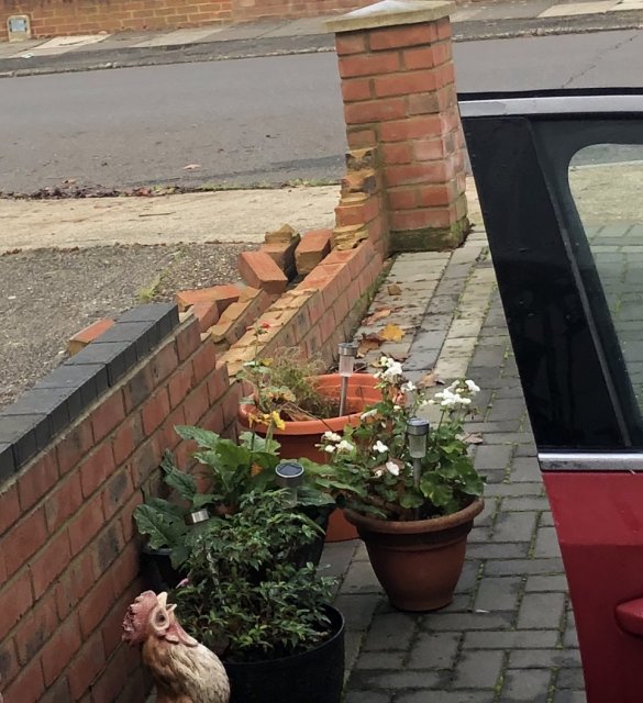

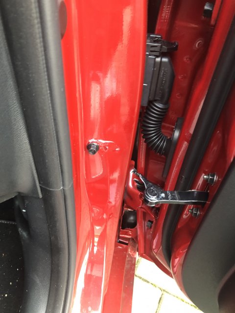

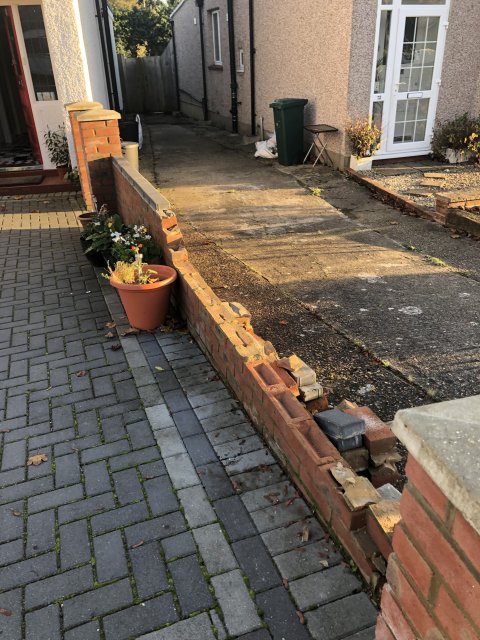

I have just had a similar issue. I’ve been driving all my life and never an issue even with the automatics that I’ve owned until I buy an auto proceed shooting brake. It was on my front drive facing the house with engine running. It was in park with auto handbrake on when I got out to get something. I managed to walk around the open drivers door to my house when the car started to reverse up the driveway to the road. The only thing that stopped it was the brick pillar by the footpath that got caught on the driver’s open door otherwise it would have reversed into the road or across to a neighbours house!! How can a car move like that on its own even with the door wide open and no one in it??

Sorry that this happened to you, but did this happen with a Telluride? It doesn't look like a Telluride from your pictures, so you should clarify that point.
