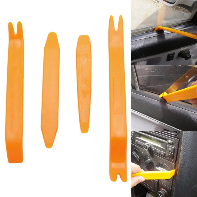

Just from looking at the headliner it looks like you can tuck the wires underneath without having to remove it. I would just pick up some panel tools from Amazon.
