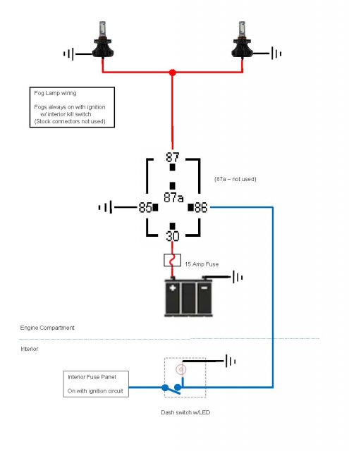

Actually, I did something like this on my '12 Escape...
Ran a wire from the fuse block from a circuit that was only energized with the ignition on; thru a switch I put in the dash; to a relay - so this switched wire controlled the relay. Wired the relay to the battery and then to extra OEM connectors I got. Unplugged the stock wires/OEM connectors from the fog lamps and replaced with my custom wiring.
This way whenever the ignition is on, the fog are on - unless I turn the switch off. On with no headlights, on with low beam, on with high beam. Never had an issue with LEOs.
Pretty clean, but not sure I'd do it to a new car, under warranty
Maybe someone can devise a easy plug-n-play option like the Infinity harness
