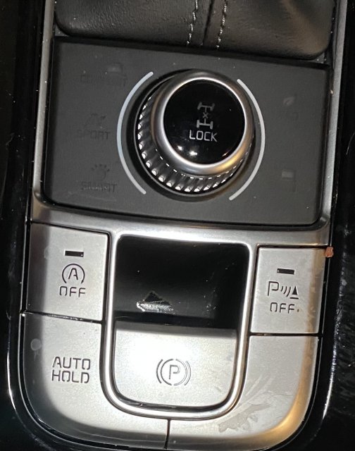

When my dogs are in the Telluride if they step on the ISG button the alarm goes off. I have tried turning it off to no avail. What can I do? I also crack windows for them. See picture of buttons.
It has nothing to do with buttons… it’s the rear occupant alert. If you plan on having anything that moves in your vehicle when it is off and locked, turn it off. It’s in your instrument cluster settings under convenience.
